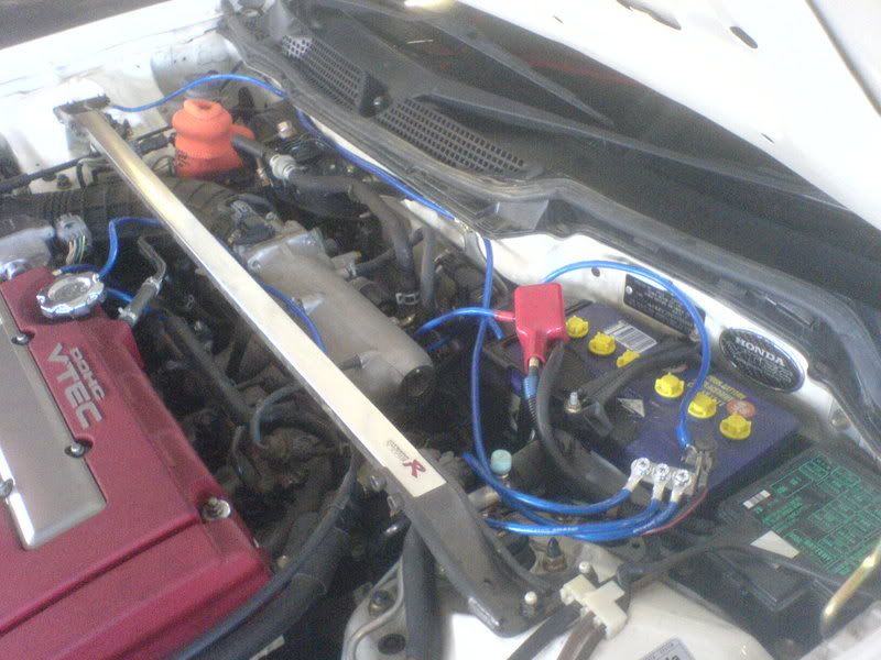

    Pivot grounding
    A pic of my installatin, you're so right the alternator is a bitch to hook up I tried but didn't in the end. Took some detailed pics to help you with installation but since you've done it I won't post them up

    Hey proton, thanks for the pic! Since you've taken pics why not just post them as I think someone else might find them useful. I'm not sure but from the pic it looks like you didn't connect one to your distributor?

    Proton, for the ground wire from the rocker cover to the chassis, give it a little more length. When you accelerate hard, the engine tilts a bit to the back due to the torque and that might pull on the cable.

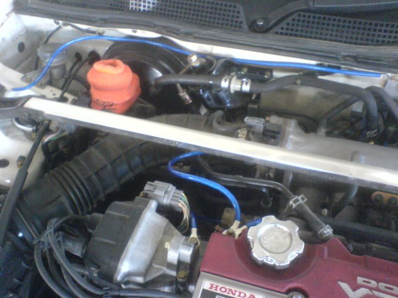

    Pic of grounding to side (Sorta) of distributor - Its that nut to the side of the distributor where the blue cable ends in the pic. I connected the main cable from the negative batt terminal to the nut on the firewall then used another cable to connect to the distributor
    Pic of grounding to intake manifold (plenum) area - Right smack in the middle of the intake close to the head there's a nut there, don't worry, its not that hot there and the cables can take it, to neaten it a bit used heaps of mini cable ties
    Pic of connection at battery neg terminal, this is sorta tricky coz everything gets jumbled up if you don't plan ahead which cable goes where
    Now stretch the longest cable all the way round the passenger side of the engine bay and connect it to the front where the stock grounding to the head used to be, then connect the shorter one to the head, but as aaronng said, maybe you'll wanna give yourself some slack

    here are the pics of wot it looks like installed
    sorz for the poor pic quality as i couldnt get hold of a digi cam. so i took pics woth my mobile.
    de_crulz: yes you have to jack the car up to get access to the alternator. bitch of a job.
